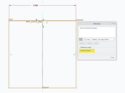

Here is a screenshot
The sketch should have been constrained vertically to the FRONT plane or to the coordinate system. But you can delete the FRONT plane, and the coordinate system has only the RIGHT and TOP plane as dependencies.

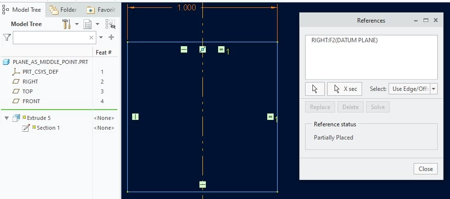

The sketch is not fully constrained. You can see this by inspection of the sketch references where it is shown that the section is only partially placed. The rectangle is defined but its location on the vertical (z axis) is not explicitly constrained. The intent manager is making an assumption to create the extrusion. This is concerning that the feature is created without a warning of the constraint deficiency.
Partially placed sketchPartially placed sketch

I agree with you: the sketch is not fully constrained. If you add the FRONT plane as a reference to the drawing, then do an Edit Definition again and delete it, you cannot exit the sketch. Therefore I agree with you that the sketch is underconstrained. This is what I said in the initial email.
My question was, how come it is possible to have an accepted sketch that is not fully constrained. Up to now, I wasn't able to have an accepted underconstrained sketch. Can you duplicate this behavior?
If you have no datums, you can make the first feature with no references, but this is not the case.
I know that there are some implicit constraints. For example, the right vertical line doesn't need a vertical constraint because the dimension ensures that the line is parallel with the other vertical line. Is there another hidden or assumed constraint?
