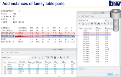

you can use your pre-existing models/family tables with IFX.
There are two possibility.
1. Add the name of the instance to your *.dat file
Simply add the instance-name of the existing file to the correct size in your *.dat file (first column).
In some cases the generic name is also required – but if you are on Windchill, only the instance name is ok.
See also: To Add a Legacy Fastener and Integrating and Customizing Parts

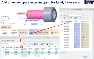

2. Use the Family-Table mapping function from IFX
Fastener Data Files
Search for ‘#FAMTAB‘ and ‘FAMPRT’ for more details.
See also page 16 and 17: IntelligentFastener_BuW_Roadshow_2017-05-09.pdf
