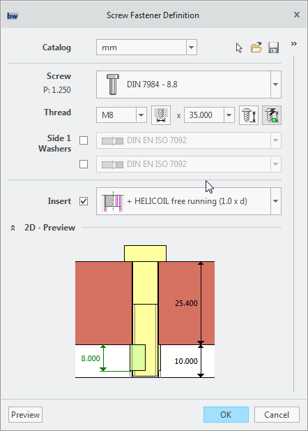

Inserts in the Screw Fastener Definition Dialog
If you have inserts in your catalog files, a layout for Insert is shown in the Screw Fastener Definition dialog. You can check the insert if you want to use it.

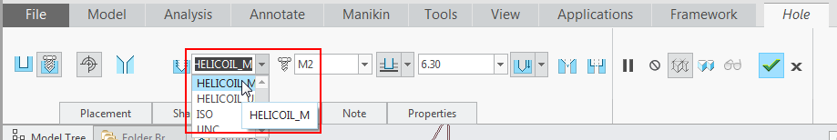

Make sure that you have a hole chart loaded for your inserts.

I just recently upgraded to M110. I was wondering, are there are there any additional steps to getting the inserts to appear in the Screw Fastener Definition dialogue?
I went to the intelligent fastener drop down and selected convert library, set USE_NEW_LIBRARY_STRUCTURE option to yes and extracted the above zip files to the correct locations. I still have no drop down menu for inserts. Am I missing anything?
OliverGräbner
Feb 13, 2017 7:17 AM UTC
you have to select a screwed connection (with thread not with nut). Then the insert layout should be available.
If you still face into problems we can do a webcast or just send me your zipped "parts" folder (oli@buw-soft.de). Then I will check what went wrong.

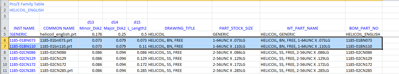

Hi Oli,
     I am trying to migrate legacy helicoil inserts into IFX. screenshots of the family table and the .dat file are shown. I entered the first two instances of the family table into the .dat file. Could you tell me if I entered the parameters correctly? I am under the impression that DN and P are the only parameters that matter in the .dat file. Additionally, I would like to use the SUBINFO feature with a string parameter in my family table (WT_PART_NAME). Do I need to write out the value of this parameter in the .dat file or will IFX automatically know to read this value from the family table?famtable.PNGdat file.PNG
Thanks for any insight you can provide. I can attach the generic model, full family table and helicoil_free.dat file if that would help. Regards,
Spencer

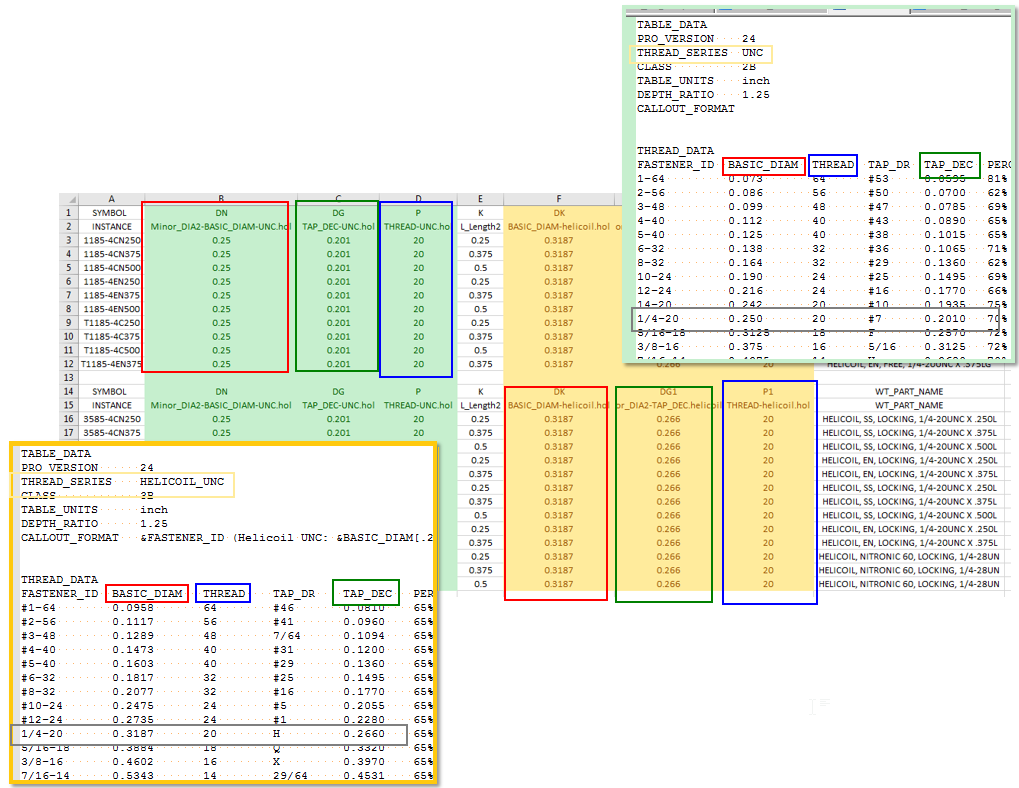

OliverGräbner
Feb 28, 2017 7:53 AM UTC
Hi Spencer,
you need the INSERTTYPE 02 I think.
Then DN an P must fit your screw diameter and pitch.
DK and P1 must fit BASIC_DIAM and THREAD from your *.hol file.
You also have to specify the other values like K (insert height) so that IFX can paint the preview and has the correct values for getting the depth and so on.
Please try it and if you don't get it to work, just attach the files and I will prepare it for you.
Oli
Oliver Gräbner - B&W Software GmbH
OliverGräbner
Mar 1, 2017 11:36 AM UTC
Hi Spencer,
I send you a mail with some explanations.
Nevertheless I will post this for other users. Maybe this will help them to understand the usage of Creo hole charts and helicoil.
  • For the INSERTTYPE_02 the green values are for the SCREW and for the screw hole in the upper part. This is used to find the matching Screw for this inserts
  • The yellow values are from the helicoil_unc.hol file. They are used to find the correct hole chart to create the hole in the connecting part.
