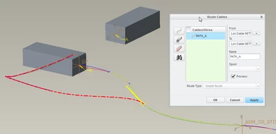

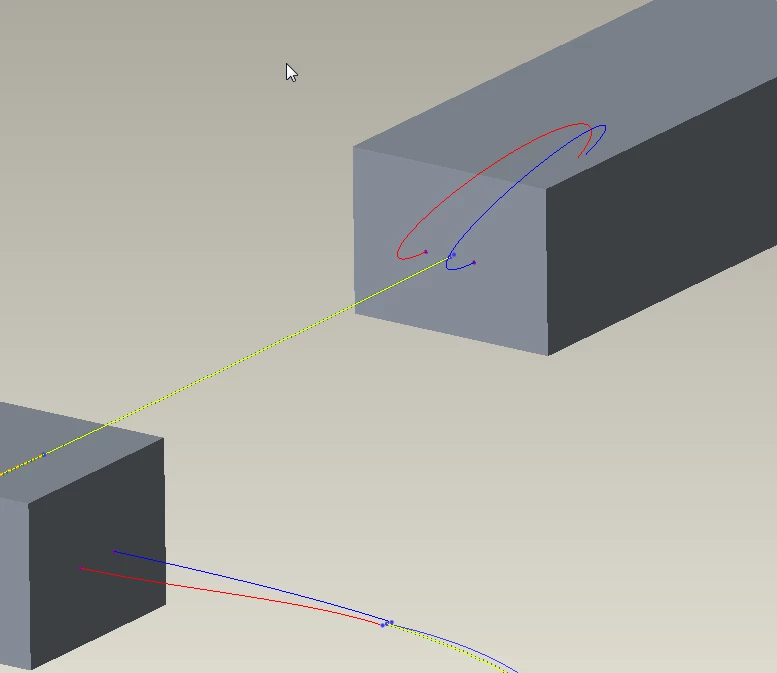

I'm trying to route two cables (obviously simplified example Smiley Tongue ). I got those modelled in Schematics and applied "USE_PATH"="PATH_A" to one cable ("ROOT" to "A").
In Creo I created a network which is of a Y-shape. As connector "A" has to have a location which is _real_ close to the other connector, Creo Cabling wants to autoroute via this location, which I don't like. So I created a "Network Path" from the "ROOT" connector to the "A" connector and named it "PATH_A".
Creo Cabling doesn't seem to like it, the icon shows broken in the model tree and the cable is still routed the same way as before. In the "Route Cables" menu, the path can be selected via the "retrieve cables from logical reference" button.
Any ideas on how to get autoroute do the job and use the paths?

If you're trying to route using cables, as opposed to individual wires, there is a known bug in Creo Cabling for this.
Bug aside, the broken view of the cable in the model tree for paths is correct.
If you're not getting the path you want, why not try the 'Follow Cable' option and use your network, this will allow you to pick the locations to follow.

For full transparency, i do not use Schematics, i have never used the network path function, and we use Creo 4. We import our logical file from a Mentor product.
I tried to recreate your situation here and i was unable to get those paths to work as intended. Either it would always take the shortest path or the wire would break with no path found. Even just using wires instead of cables.
My suggestion with our business case is to terminate the network all the way to the coordinate system you are routing your wires to. That seems to create that link needed in most cases to resolve these network location proximity issues. Otherwise your only work around is to manually route the cable or move that location point closer to entry port of A.
There is also the location point priority settings.  I don't think they will help in this situation but it would be worth a shot to experiment with those.

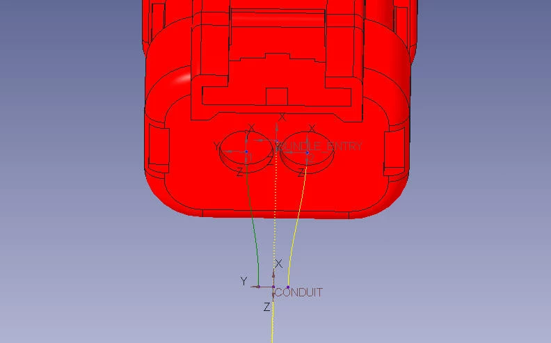

Getting closer is not an option unfortunately, as the wires need quite some space to prevent "loops" (with more than two wires the problem cannot be solved by setting the locations rotation parameter).
April 1, 2019
Gotcha. Yeah you can't have that second point on the network too close. Here is what ours looks like. We have the network terminated to the connector on 1 coordinate system, no wires get routed here, it is just for the network. The wires route to their cavity coordinate systems. Then there is one offset point or coordinate system point for the cable jacket to terminate to. All this is done via importing an NWF and using the auto route feature.
