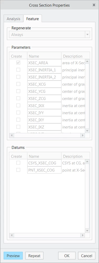

If you have BMX and create the section analysis you will need to select items in  in the feature tab as seen below to be able to access the parameters within the feature. Select the box for anything you want access to.
