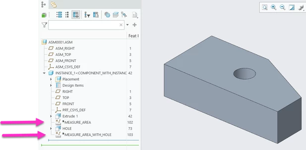

Also, something I see a lot is people creating measurements, sections, etc. in a family table instance -> this results in the created items being suppressed in the generic and all other instances of the part, as well as them all being added to the family table.

You may have left out some important information. I suspect this is related to the implementation of a family table for your component part. It appears in the model tree for the assembly you are placing an instance of a part.
Is your component where the analysis features are defined and instance from a family table? If so, are you certain that the analysis features needed in the assembly are defined to be part of the instance you are attempting to use in the assembly?

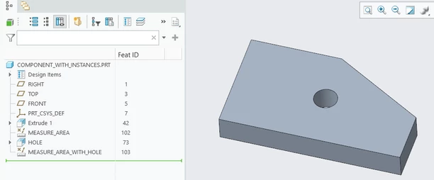

Jan 18, 2024 4:23 PM UTC
I appreciate your reply.
I switched to the generic part, and it was not suppressed.

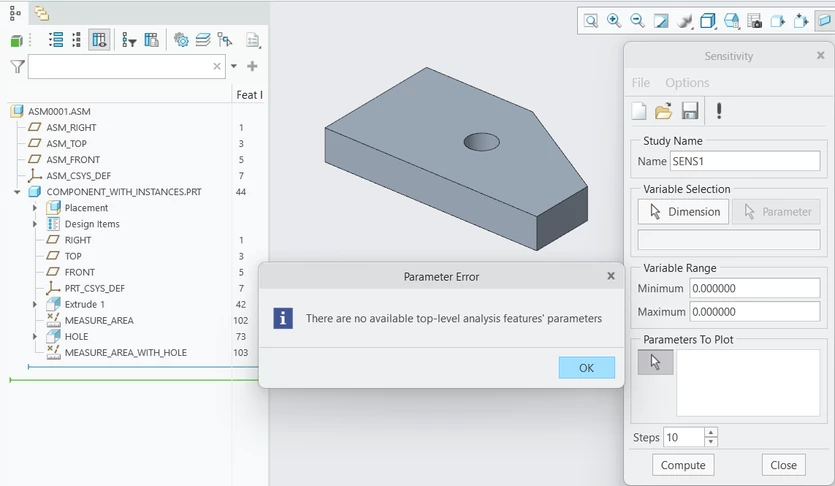

Anyway, even in this situation, I am unable to use alaysis feature values. Creo requires that they be at the top level.

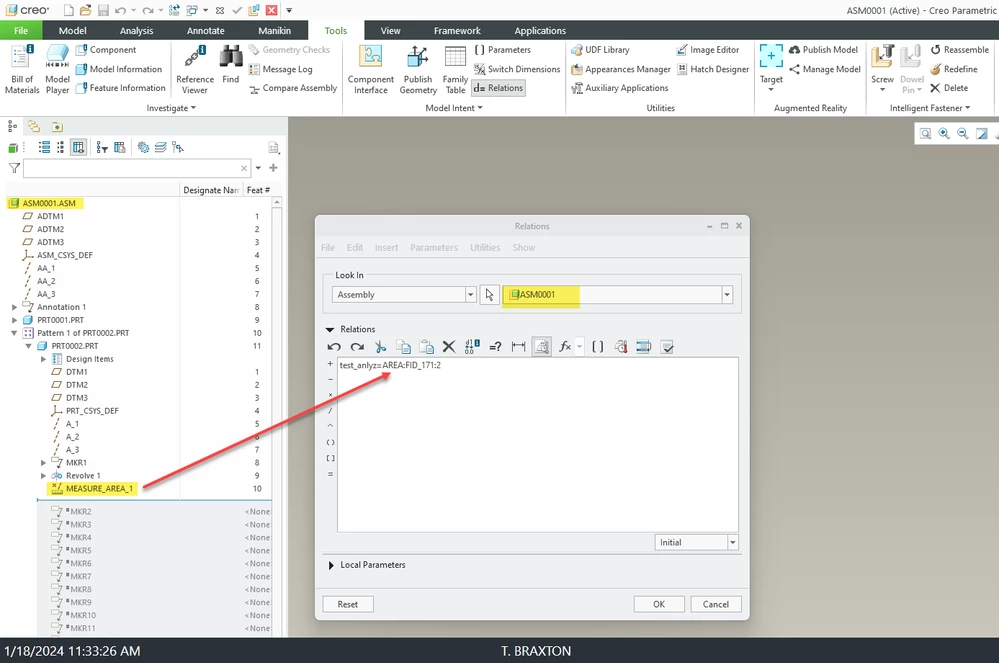

You are attempting to run a sensitivity analysis in an assembly and want to use an analysis feature defined in a component of the assembly? That is not at all clear to me from the first post. You will get a better response if the problem statement is more complete.
You can access the analysis feature of a component for use in an assembly as shown below where I am using it in the definition of assembly relations. This is not the same as using it in a sensitivity analysis. Perhaps you can create an assembly relation that you can use in the sensitivity study.
