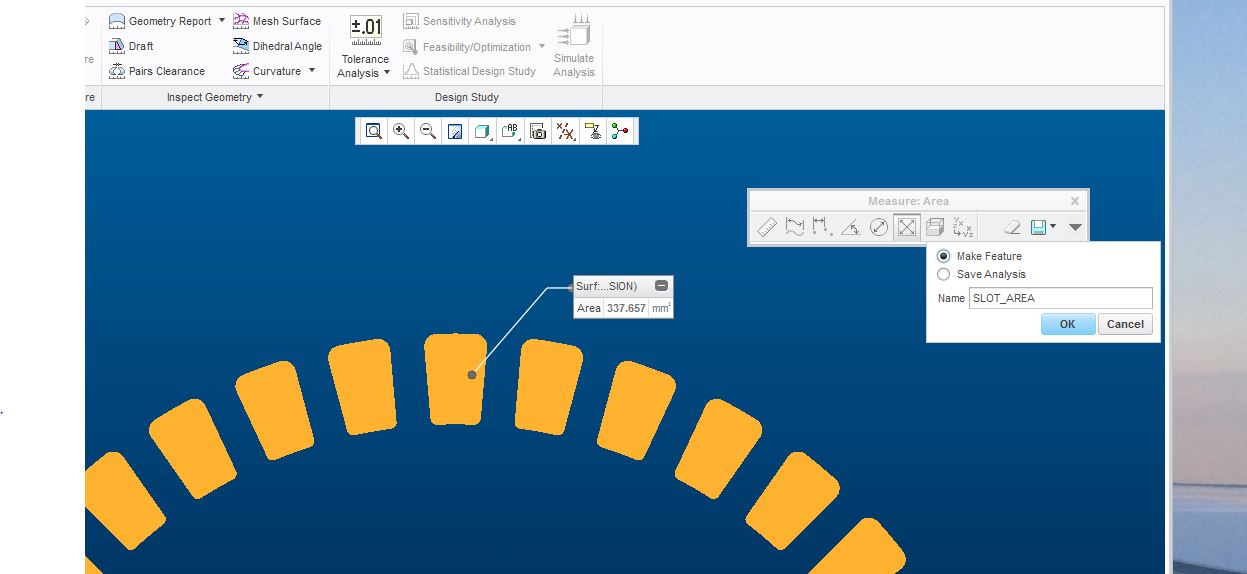

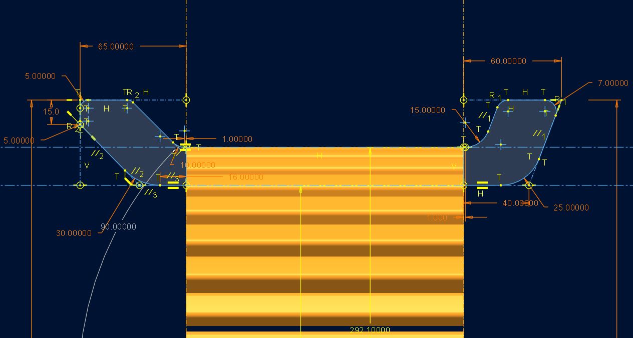

The slot area is found using the analysis tool. The area of each side of the end turn needs to be equal to 6 times the area of the slot. I want to creo to automatically calculate the height of each end turn in order to be equal to the 6 times the slot area. The slot area calculation is shown below. The End Turn sketch is shown below that.
Let me know if you have any ideas of how to do this.

MUCH better. How accurate does it have to be? By "end turn", you mean removing material?
