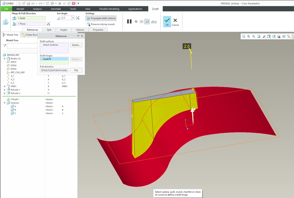

It is permitted to use a quilt (curved or flat) as a draft hinge but there are limitations in the context of the draft feature when selecting a quilt for use as a hinge. It appears that you have a spherical surface that you want to use as the draft hinge. Creo has limitations on some axisymmetric geometry due the fact that all circles are split in half. I suspect that is an issue with the quilt you want to use in this case. If you were to extrude the same radius it will likely be usable as a draft hinge but when revolved, it will probably not work.

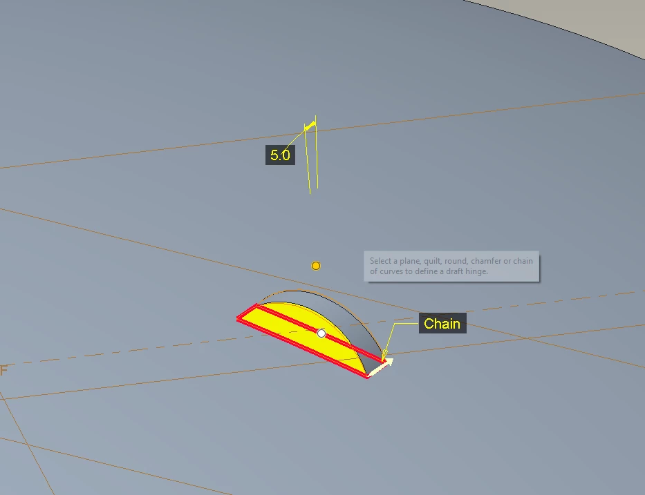

In your example the method I would use to create the draft feature would be to explicitly select the intersection of the drafted surfaces with the hinge surface (quilt). I think you will find for this geometry that this will be a much more robust approach. Note the use of intent references in the draft feature which will make pattern instances more robust with model edits.

Thanks for replying,
The screenshot was just something i threw together for representation. I wanted to highlight the use case of a series of draft surfaces that could in theory use the same surface as a draft hinge, allowing for a single draft feature in place of multiple set utilising their individual intersecting chains.

Here is an example of using a curved quilt as a draft hinge reference. Note that the quilt is not axisymmetric as in your scenario.
