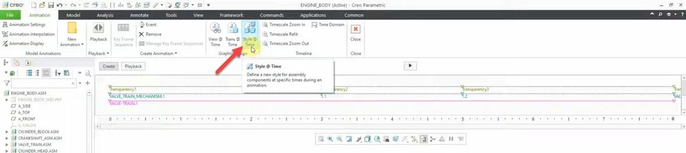

Once you have an animation created, use the style at time option to switch out the rep you need.
Alter style state within animationAlter style state within animation
