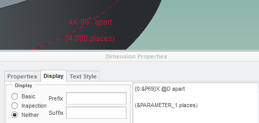

Is it possible to get the pattern quantity to not show any trailing zeros in an annotation without creating a 'work around' relation?

Yeah that's exactly what I thought, but it has been like this for years now. Our work around is this:
flange_holes=p0
then add &flange_holes to whatever note, but this is super annoying to do every time for every pattern.

It's the parameter "flange_holes" that is reporting and displaying the decimal places.
Try adding this...
{0:&P0}X @D (Plus whatever additional annotation text you need)...
Add this directly into the Dim.  properties instead displaying the parameter valve.
You have to edit the Dim properties either way but this text eliminates the need to create the relation.
Hope this helps - & STUFF

The relation FLANGE_HOLES is created as a work around because the &P0 value shows trailing zeros.
Using FLANGE_HOLES like this, "&FLANGE_HOLES[.0] @D,  the annotation displays correctly as "20 1 1/4"

Check out lead_trail_zeros  and lead_trail_zeros_scope
You can control Leading / Trailing zero display with these 2 settings.  If none of your other dims. are showing trailing zeros try setting the scope to ALL
These are detailing options that are typically set in the drawing but are also available to be set in the model for the MBD folks.

No luck with that either.

Hmmm...  Is your screen shot above displaying the parameter?  or the p dimension?
I think displayed parameters will always show Trailing Zeros..  If you can remove the relation and use {0:&P0}X @D text in the dim properties it should work.
April 25, 2017
Would you be willing to upload the model to this discussion?  If so you can use the advanced editor to attach it (top right corner of the reply window.)
