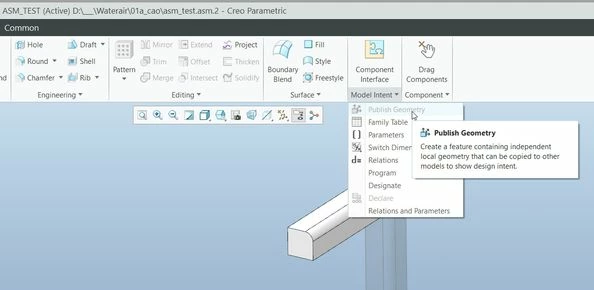

I used to use Publish Geometry and skeletons with my Creo3 Advanced XE.
I now have a Creo7 Essentials licence.
One of Optional Modules : #Optional Modules = ASSY_PERFORMANCE.
But it seems that I can't use Published Geometry.
Is this normal?
Any advice?
Thank you

I've used Geometry publishing many times, but option is grayed.
you cannot believe every thing AI tells you.
Information provided by @tbraxton is correct. You need license containing ASSEMBLY module.

I think this is to be expected with an "essentials" license. Look for the advanced assembly extension being activated in the license file to confirm. Without the AAX most of the top-down tools are not available.
Comparison of license package capabilities here:
https://ptc-p-001.sitecorecontenthub.cloud/api/public/content/ee486c4245dc42a29522094e9c1d692c?v=4336023c
This would suggest that top-down tools are not included in an essentials license.
