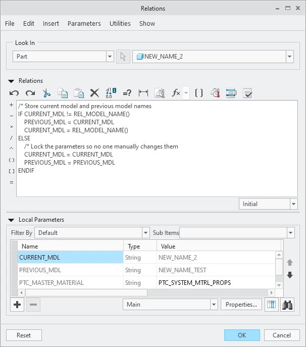

Relations example.  A regeneration is required after the 'Save As' in order to update the parameter values.

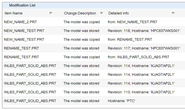

Here's what the file history shows:  (Tools -> Investigate -> File History)
The PREVIOUS_MDL parameter (from the model) could then be displayed on the drawing:

Welcome!  Unfortunately this capability is not available 'out of the box'.  While a part does store it's history internally, this information is not exposed in any way that can be read by the drawing.  It might be possible to access this internal information with certain programming tools (C++, Java, etc.), but that is probably way beyond what you're ready to tackle.
If you can modify your Creo start parts, you may be able to create part level relations that will store the previous model and and then expose this as a parameter that could be displayed on the drawing.  Unfortunately this will only work for new models created after this was added (unless these same relations are added to other existing models.)

If the relations already exist in the model, then it would actually.  As long as CURRENT_MDL was already populated, any future change to the name would be caught the next time the model is opened in Creo and regenerated (regardless of whether that change occurred in Windchill or Creo.)  Granted, if there were multiple successive save-as (or renames) events in Windchill without ever opening the model, then it wouldn't have any record of the intermediate steps, it would only see the last one.
