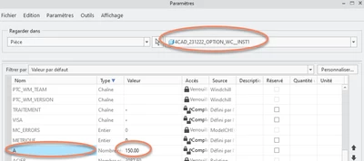

I find this comportement very strange but i know that it's possible to drive a dimension with a parameter in inheritance:
1-PART A with dimension driven by parameter
2- PART B with PART A in inheritance and with variable parameter and relation but with error with = or ==

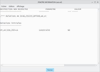

And with == i obtain this error

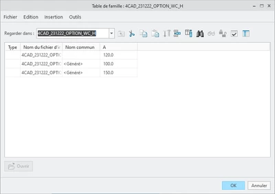

But when i put this parameter A in family table creo calculate the value with good value in each instance but with relation error
Why creo permitte to do this if not possible??

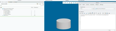

I am not inheritance expert ...
1.] I removed relation d18=HT_AX from 4cad_231222_option_wc.prt
2.] I created 4cad_231222_option_wc_inh.prt and added relation d18:***=HT_AX
See uploaded inheritance_2022-12-24.zip

This is difficult to evaluate without some actual models with the dependencies you are asking about. Please post some test models and indicate what version of Creo you are using. I would approach this type of issue as you would debugging programming code which can only be done with the code (the models).

I'm using creo 8.0.5

Yes you have reason, usually i do it as you explained but many users try to driven parameter with a second parameter in inheritance part.
I will ask to ptc if it's possible to prohibit this action .
