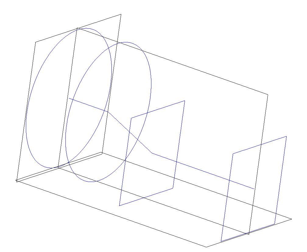

In the good old days I remember using this tool. However (not used it in a while) I now need to use it in Creo.
I have created my trajectory and sections (all made out of 4 segments) and go to the swept blend tool
However I seam unable to select more than 2 sections, start and end. Am I missing something I have looked in the help which is of course no help!!
Can anyone provide an in site?
October 14, 2015
Variable section concept is using single section & mutiple trajectory. In this case you need to use swept blend.
