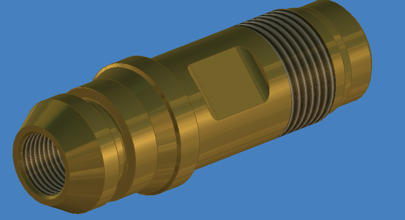

Here is a screenshot from Inventor. It is just an image on the 3D model which is automatically placed when selecting thread. It does not add any weight to the file and it is understood as thread for the 2D drawing. When vizualizing the 3D model it is obvious that we have a thread here. It helps understanding the design.
What is PTC solution as I really do not see any improvement even with Creo 3.  The Intelligent Fastener seems to be only for standard hardwares.

Sorry, but I don't have a great solution for you.  Personally, I always just model threads at a slightly different diameter than the rest of the shaft, and change the color.  (This makes it easy to determine if you have the right grip length, by observing if the colored portion is sticking out of the hole or not.)  I've never had a need to actually model threads, or show them graphically like in your image.  I suppose you might be able to get a similar effect in Creo by creating a long skinny JPEG of one thread, and applying it as a repeating texture, changing the scale as needed to get the right pitch...  but that seems like a lot of trouble.

I would like to 2nd Chris's point that there is not a good solution illustrating threads in any version of Creo. This has caused issues with us in manufacturing and assembly. It is too difficult and memory intensive to model threads so we use cosmetic threads and this causes its own round of problems because you cant see the threads on interfacing parts. Not to mention the issues that cosmetic threads have in a drawing. I am familiar with inventors method of handling this and don't understand why PTC cannot implement a similar solution. What I have done in the past just to fake some threads in is to apply the image below to the threaded surface and stretch/shrink. And yes it is a PITA, and it looks like cr@p in drawings.

It looks from the OP image that they used circular ridges rather than helical threads as a short-cut.
