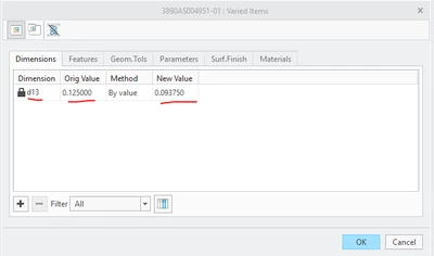

Looking to clean up some warnings in an assembly lots have worked on.
A part was assembled as a varied item (flexible). Looks like it's done legitimately?
I get the warning below when opening assembly. Anyone know why?
Creo4-m020

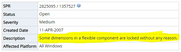

The resolution is not terribly helpful, but this KB article seems to match what you're experiencing:
https://www.ptc.com/en/support/article?n=CS133724
December 6, 2019
Similar article for later versions of Creo:
https://www.ptc.com/en/support/article?n=CS104016
wfalco16-PearlAuthor
December 6, 2019
I guess this was not resolved?
  • Reported to R&D as SPR 2825095
  • Works to product specification for Pro/ENGINEER and Creo Elements/Pro
  • Remove the Varied Items and redefine it
  • Under consideration by Product line management
December 6, 2019
Apparently not.  If you look at the corresponding SPR, it gives a little more info:
