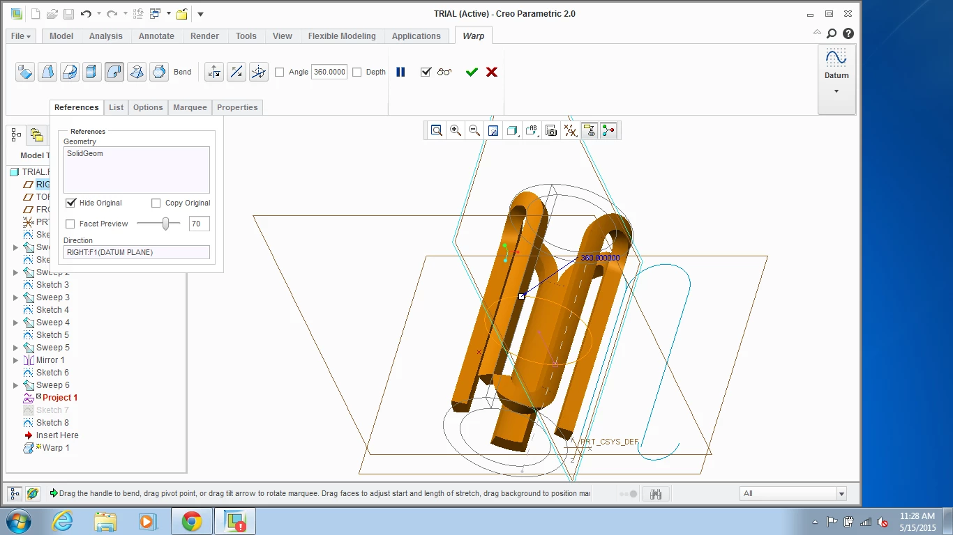

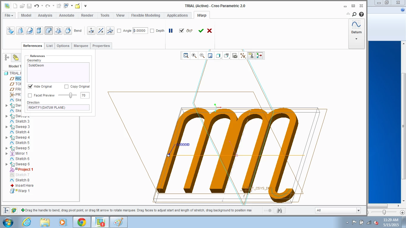

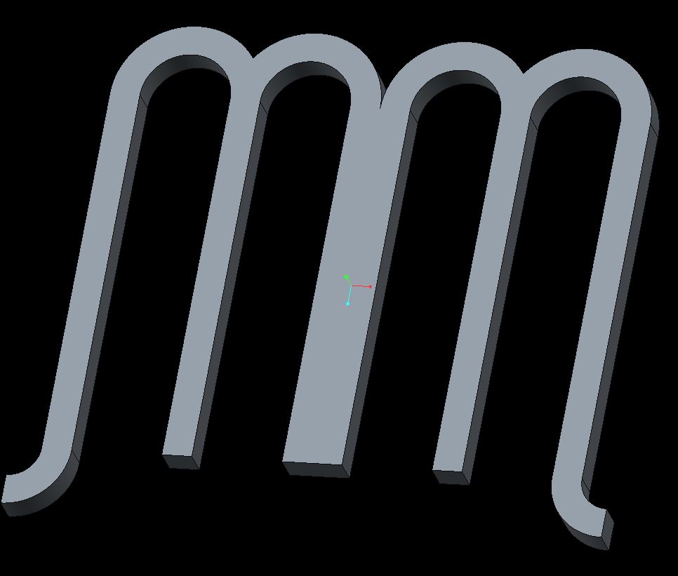

Hi Guys,
I want to bend the solid into a cylinder.So i use the warp feature in creo but I am not able to achieve the bend completely.
I am attaching the screenshots .Basically I would like the bend to be complete by ending where it started.
Thanks in advance.

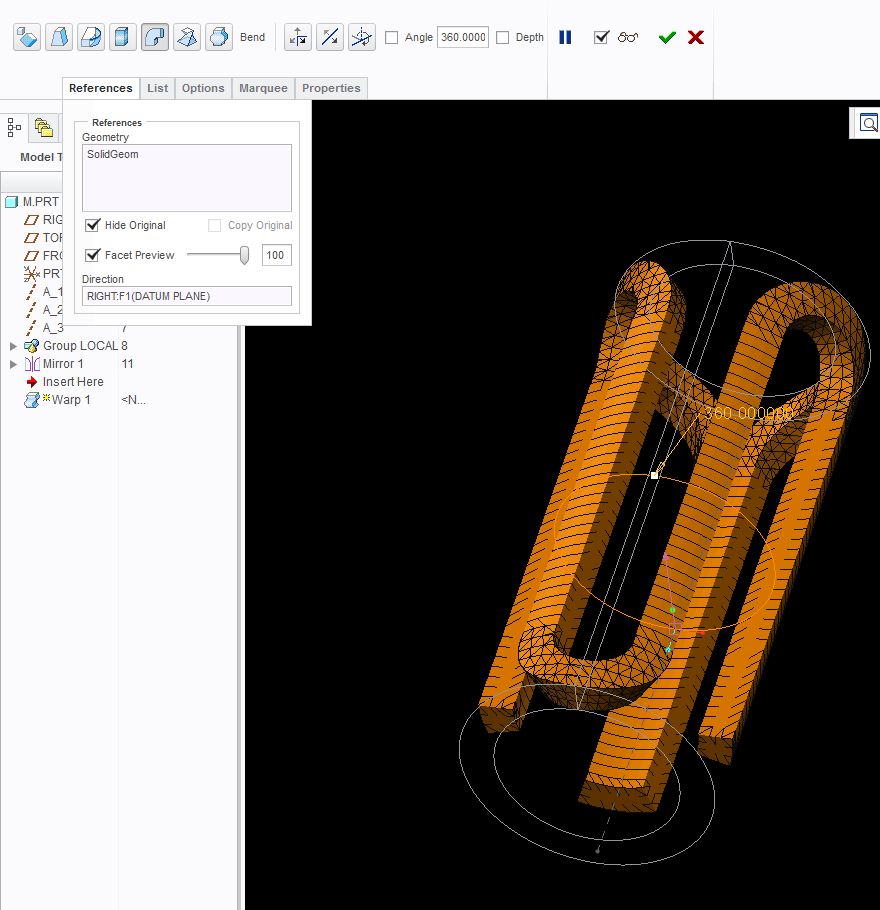

Yep, you can
Creo 2.0 full version attached

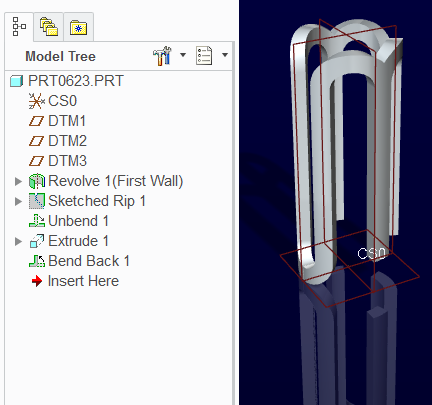

Have you tried a spinal bend feature?
May 16, 2015 6:47 PM UTC
May 16, 2015 7:28 PM UTC
Nice one, Matt.
What Matt is showing you is that the part if wrapped 360 degrees without overlap. The hook at the end of the OP's image requires >360 degrees of warp.
Warp can be a tough nut to crack. It is missing some important control features, and others are hidden. It is not ready to replace Spinal or Toroidal bends yet.
BTW, you can probably do this in sheetmetal as well.
