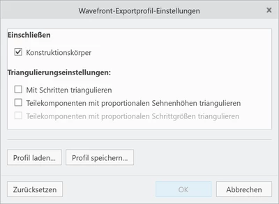

- I define a new file name and choose the right type, in this case wavefront (.obj)
- the wavefront export settings I dont change:

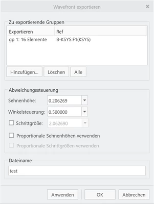

- the wavefront export window opens. I choose the coordinate system of the assembly to define the export. Sometimes (not this time) the String height, Angle control and / or Step size I change but this should't change the colours.
- I press "apply" and "ok"
After this process, I find the .obj and the .mtl file in the save path.
So, would you be so kind and check my export process, please and tell me, if there is something wrong.
