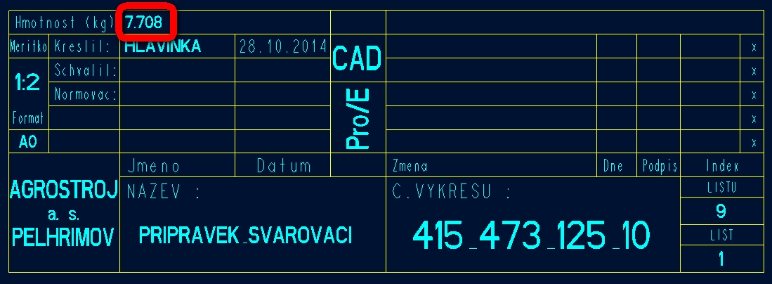

Is there some way to show (in drawing) the total assy weight without parts excluding the simplified representation?

hi,
you have to sum mass in repeat region.

thlavinka1-VisitorAuthor
October 28, 2014
Thanks Krzysztof !
BTW: isnt there some posibility to have the information in frm file (similar to "&pro_mp_mass)?
this value in red square represents the total weight (including parts that are actually not a part of the fixture...)
B.R.
T.
October 28, 2014
It i spossible.
In frm file you have to add repeat region with right sum.
