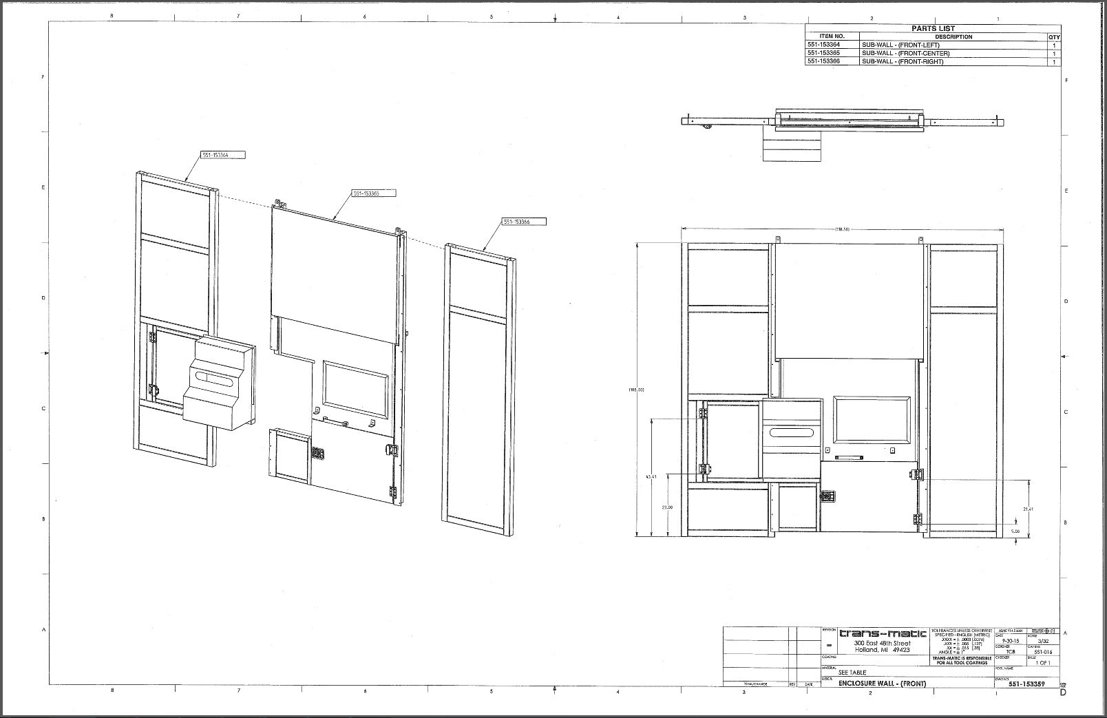

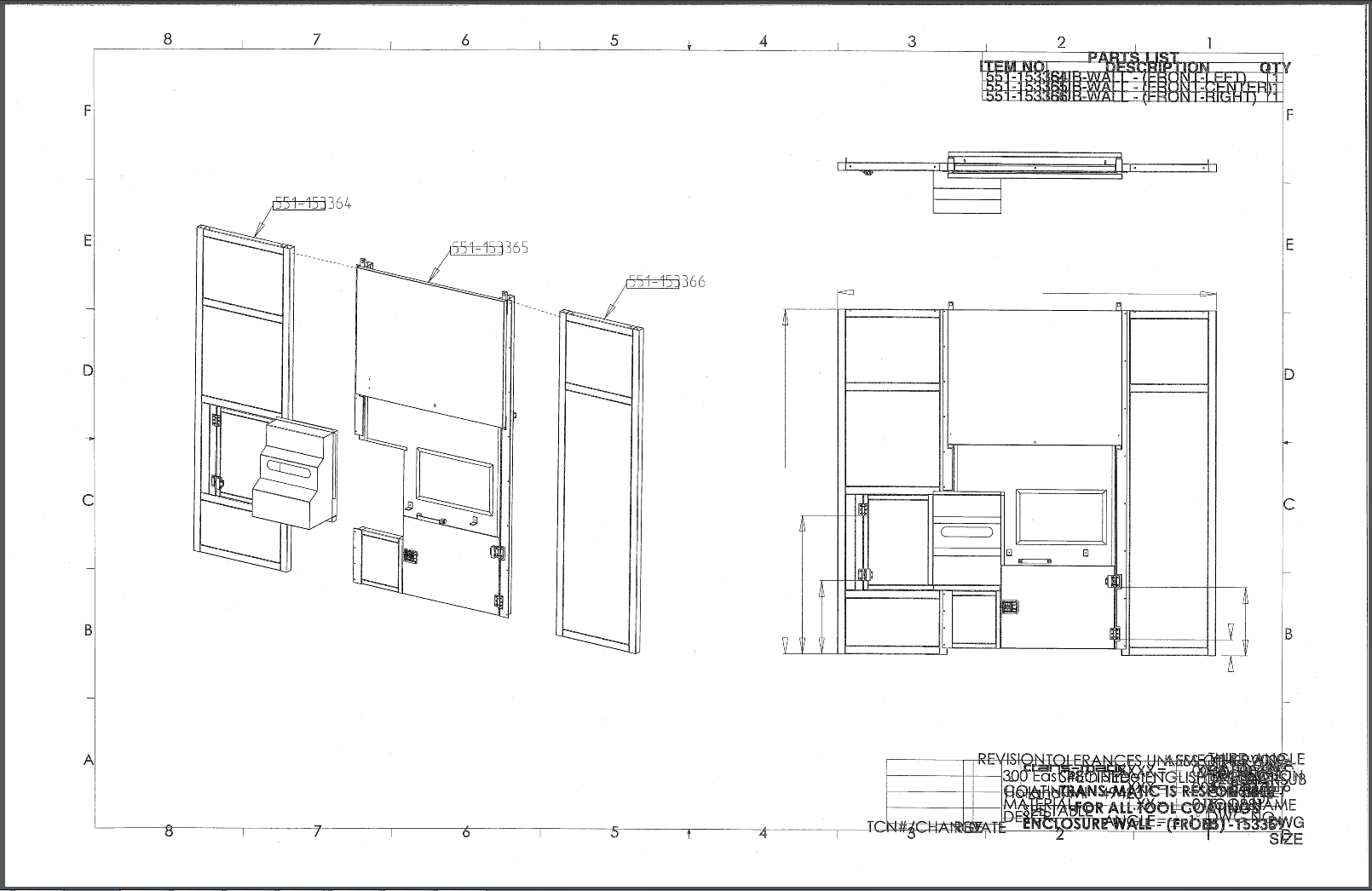

We are having an issue where drawings will sometimes print out with the all the fonts incorrectly scaled up.  These drawings do contain TrueType fonts, but they're not being sent to the printer that way.  The plotter config files are telling Creo to stroke all fonts before output.  What makes this so confusing is that the output can be right one minute and wrong the next with no changes to the Creo session (as far as I can tell).  The exact same user on the exact same computer printing the exact same drawing to the exact same printer (with the exact same method) is getting different results.
Now technically this is probably an automation question since we're using B&W's SmartAssembly to automate the printing, but I hoping to increase exposure by leaving this in the root Creo context.  I'm really hoping someone has seen something similar, regardless of whether or not automation was used.  No matter what I try I haven't been able to figure out how to make Creo stop doing it when it is happening, or cause it when it's not happening.  Please let me know if you've ever seen something similar.  Thanks.
Creo Parametric 3.0 M060
B&W SmartAssembly 5.0 M130
Correct Plot:
Incorrect Plot:

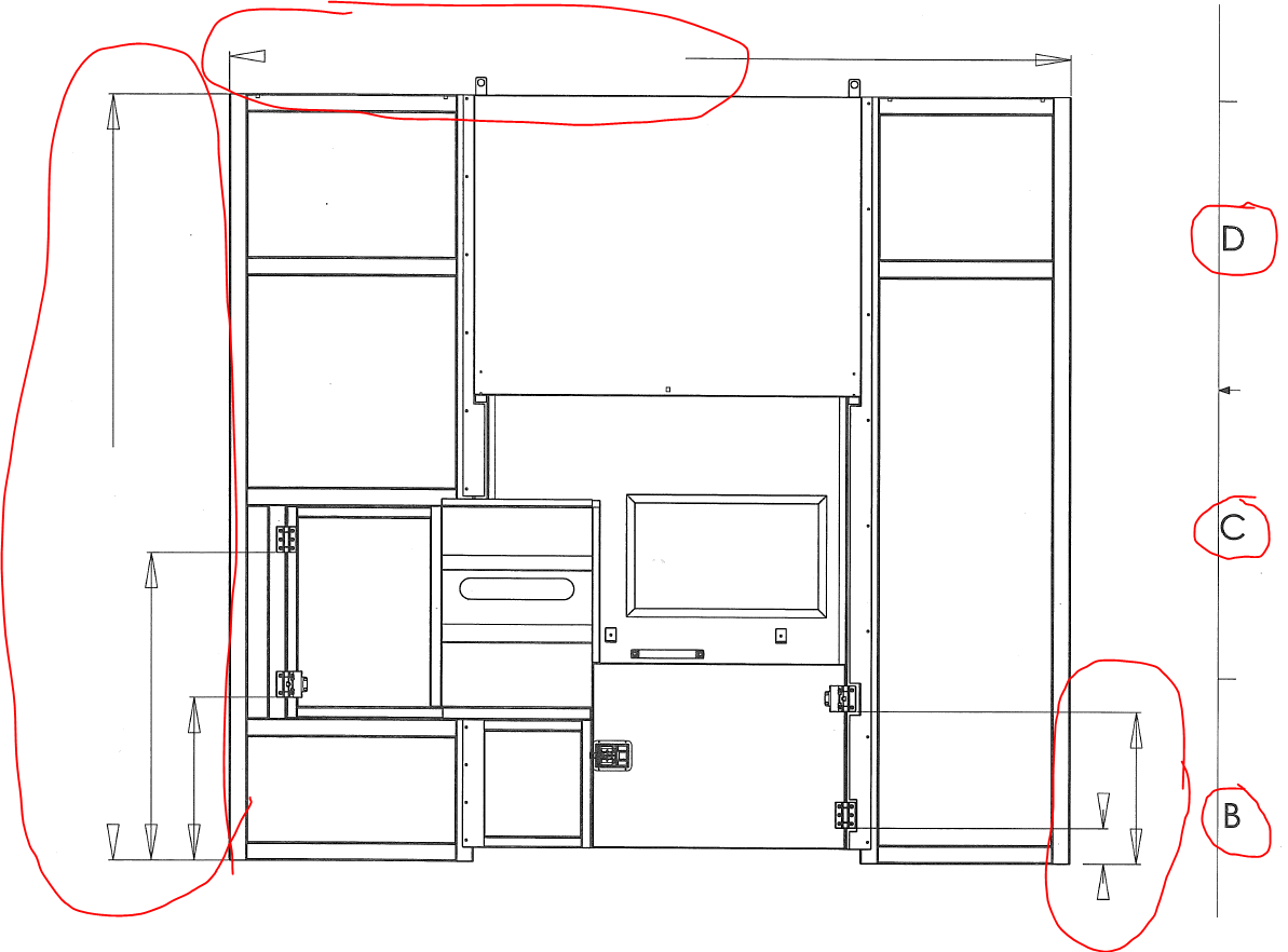

Edit:  I just noticed that the dimension arrows are being scaled up too, so this seems to be some type of scaling issue beyond just the fonts.

another strange thing is that dimensions has disappeared from right view...

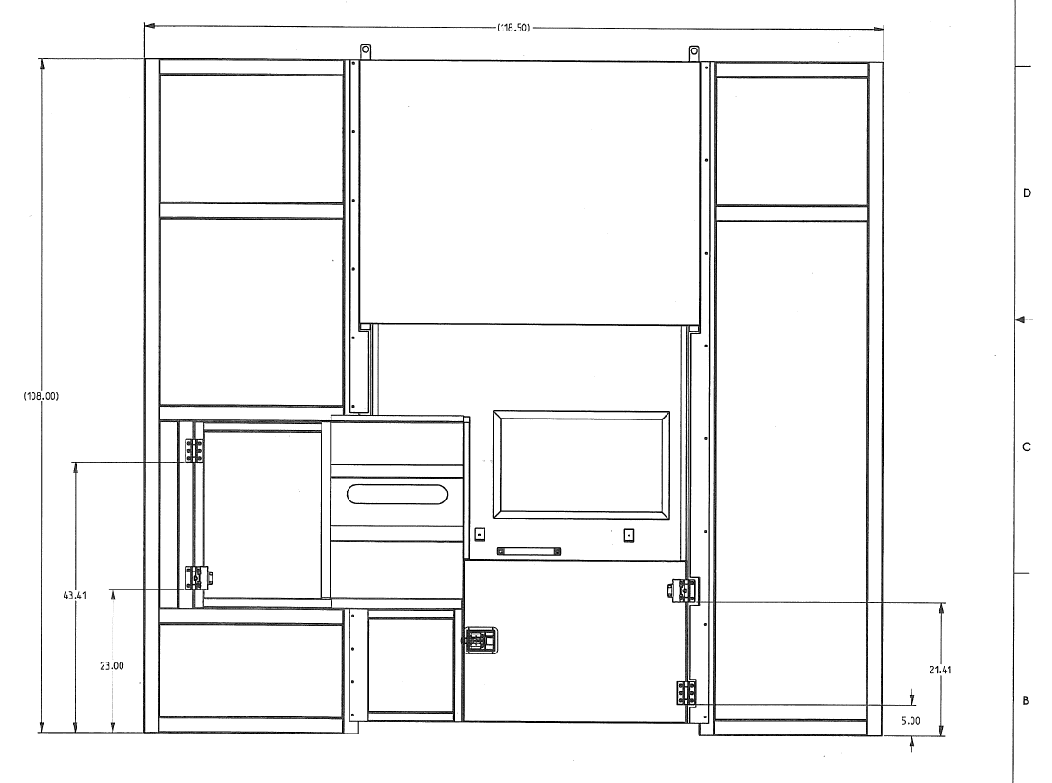

The PCF and pen table files are attached, but I really don't think they're the problem since one time it prints fine and the next time it doesn't.  Stroke fonts is turned on, plus, the dimensions are disappearing and the dimension arrows are being scaled up too:
They are supposed to look like this:
