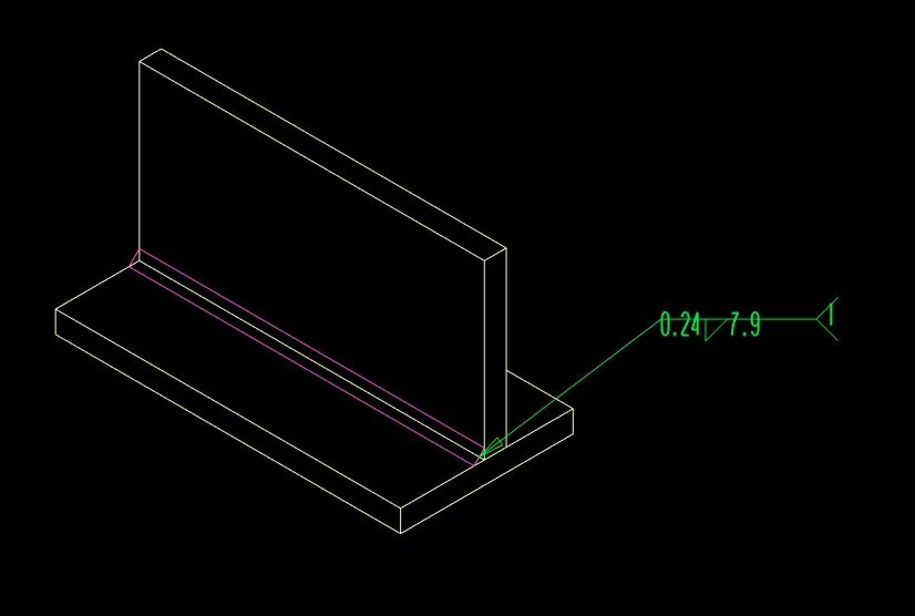

Good afternoon. Hoping for some help to resolve this. When I am using the model weld annotations in the drawing, they have the leader line right through the center of the text as well as overlapping text. The annotation looks fine on the model. I assume this is a drawing property setting but I have been through them all and can't figure it out. Picture attached. Appreciate any help.

I guess the problem is related to text font.
In your drawing try setting following option temporarily to verify my idea. Older releases use default_font option, newer releases use default_annotation_font option.
default_annotation_font font.ndx
-OR-
default_font font.ndx

Martin. Thank you! Changing the default_annotation_font  back to the default font.ndx did the trick.
