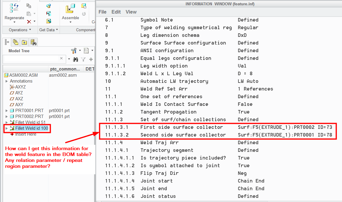

I am trying to get the weld infor in the weld bom table.
I am able to get the required parameters except for the parent parts which are getting attached with the respective weld feature.
Refer attached snap for more details of my query.
Thanks in advance.

Yes, It is possible using feature visit.
First Get Model Handler and then visit each feature.
Right now I have complete this project using ProToolkit.
