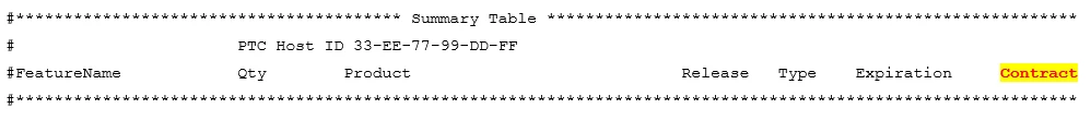

thanks for the suggestion,  when thru the various steps to log an issue thru 'PTC Support', and got stopped as they need some SCN number..  No idea what this is, nor where to get it..  so, no ticket produced..  (And 15 minutes wasted..)
Apr 9, 2024 2:08 PM UTC
You can find SCN in license file in Contract column
