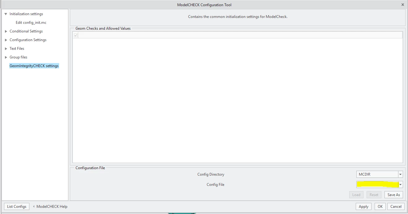

Jul 27, 2018 10:46 PM UTC
Hello All,
I am new to Creo ModelCHECK  and facing similar issue, I have created new MCDIR and created my own Config files and placed in my MCDIR, but I could not able to load the config options as. Can anyone please help me? Appreciate your help..Also please guide me if any tutorials are available.
Naidu
DomenicLaritz
Jul 30, 2018 7:22 AM UTC
Have you set the following config.pro setting:
modelcheck_enabled yes
And according to PTC's article CS57367 ("How to configure ModelCHECK in Creo Parametric") the usage of the environment variable MCDIR was supported until Pro/ENGINEER Wildfire 4.0 M090.
Since Pro/ENGINEER Wildfire 4.0 M100 you should use following config.pro setting modelcheck_dir instead of the environment variable MCDIR.
