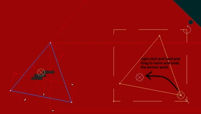

2) copy + paste in sketcher, followed by using the RMB-drag to move that anchor point around

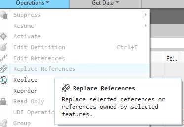

3) the replace references tool is very useful when a part is copied from another project and you need it to use an already established skeleton.

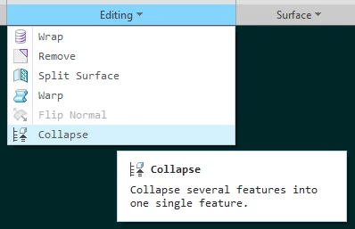

5) The "collapse tool" is useful for creating static context and making your models "stand-alone":
