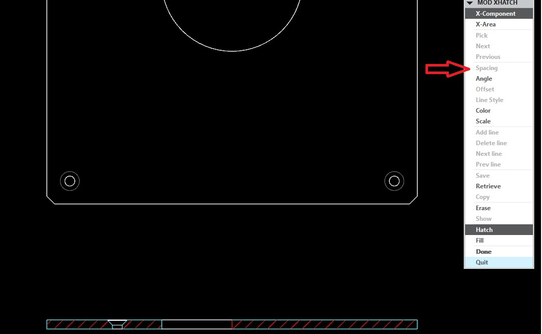

What happened in Creo 4 M010 drawings when you need to adjust the distance of the lines in the cut?
  • April 6, 2017
  • 3 replies
  • 2029 views
What happened in Creo 4 M010 artwork when it is necessary to set the spacing of lines in the choice of cut in gray always worked not now hatch.jpg
2-Explorer
April 6, 2017
Did you try "Scale"?
There's a new Xhatch method available in Creo 4 that uses complex methods for which Spacing may not apply; I'm guessing that's this case because Scale would not apply to algorithmically generated lines.
April 8, 2017
...we still have this kind of menu in Creo 4.0.......
