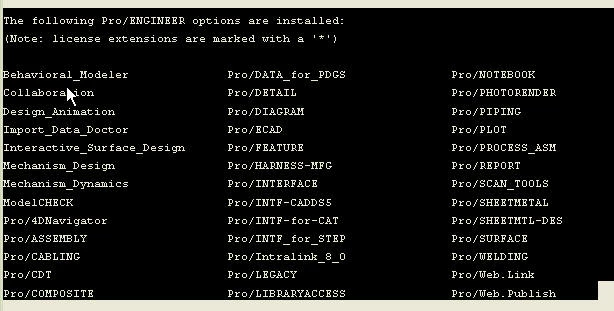

Thanks, Eric. Open question, then. Anyone happen to know then what the new option name is for the advanced assembly? I can't believe that we don't have it. This is what my info says we've got installed (see attached jpg). Wildfire 3.0, by the way. we're moving to 4.0 in march. Thanks!

Mech dynamics has AAX built in. Try one thing, create a new assembly and then select the create component in assembly mode icon (its below the assemble component) and see if you get skeleton as an option. Maybe that is why you don't see the skeleton option. Remember with each release of Wildfire they like to move things around and force you to look at the menu mapper just to find out where this function got moved to.
