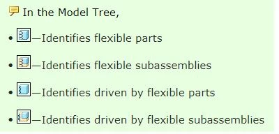

I observed parts and assemblies in Top assembly which are having icon similar to flexible part/assembly but quite different. When I check on PTC site for help, I found that they are driven by part and driven by subassemblies.
can anyone explain me to clear the concept?

In my case, I have two suassemblies and I have created one flexible but on other assembly I can see this symbol (quite different than flexible symbol...refer attachment) without I modified it. But that assembly is having common part for which I have applied flexibility in first one.
So I just want to know if this affects my other subassembly i.e. is other subassembly is also become flexible or it is just a flag to notify about flexible part below it?
