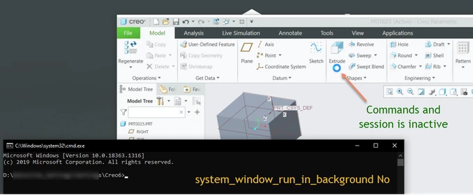

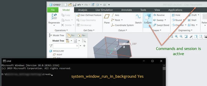

    @scaponio
    Config option "system_window_run_in_background" is to block or Unblock Creo Parametric when system window is active.
    When a user enables system window (Command Prompt/DOS Window) for any operation e.g. Purge, Creo Parametric Window deactivates for user. When the config option is set to yes, Creo Parametric will not deactivate for user, it will allow user to work in Creo Parametric without closing the System Window.
    I hope this will help.
    Thanks.
    EDIT: Check images for clarification.
