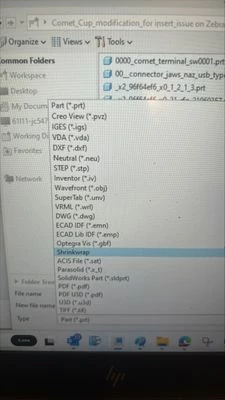

Hi there, I used Creo Parametric Version 9.0.3.0.  I don't have stl option when I click "save as". Dose anyone have this same issue? Thank you in advance for your help!

As I suspected, no solid geometry. You are not able to export to STL from Creo without solid geometry in the model. Check with a solid part and you will see the STL option. If you see it with a solid part, then it is not a licensing issue.
I have never seen any license of Pro/E or Creo Parametric that did not support export of STL format.

Are you certain that when you are attempting to save as the active model has solid geometry in it? Check that and report back here.

You also don't have
-CGM (*.cgm)
-Render (*.slp)
-EDMD (*.idx)
-Medusa (*.asc)

That option will depend on what level of licensing you have, I think.
It does appear in my Design Advanced license and I will venture it will be in the Design Advanced Pro. too.
