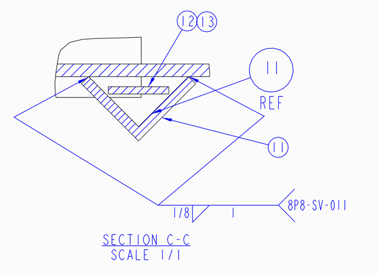

When we place a ref balloon the size and references aren't the same as a normal balloon. Does anyone know a way to get both balloons in same size?

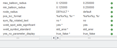

I just made maximum and minimum balloon radii are same, Even though I am getting same.

In this below view, we can see the size difference between the reference balloon and the normal balloon. This is the main problem facing when I want to place the reference balloon in another view.
  • maximum and minimum radii values of balloons

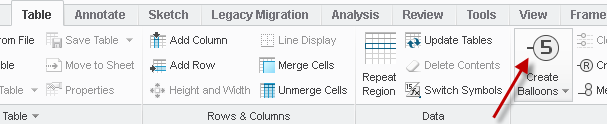

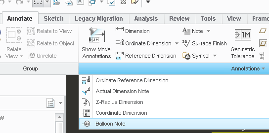

There are 2 "balloons" in Creo.
The "balloons" the config option max/min balloon radius controls are note balloons created under annotations. This option will NOT affect repeat region BOM balloons.
I believe you are referring to BOM balloons that are generated from the TABLE tab under create balloons. These are control by symbols located in the folder "LOADPOINT"\Common Files\MXXX\symbols\report\bomballoon\ .
To correct the size, you will have to edit the symbols.
