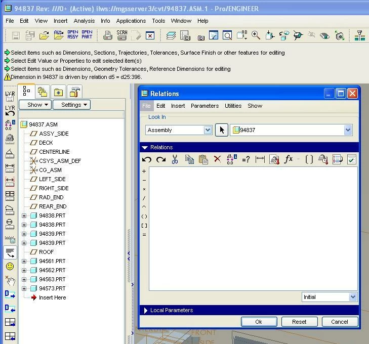

Well, this is something I've never seen in 11 years of pro/e use.
I attempted to modify a dimension, and got the message "Dimension in 94837
is driven by relation d5 = d25:396." Since I'm working in assembly 94837,
of course I went to Tools > Relations. And.the relations window is blank?
What the..? Has anyone seen this before? I checked the "Post Regeneration"
section - they're not there, either. See image below.
Some more info: the :396 extension in the relation refers to a skeleton that
drives the assembly that this one was duplicated from, but somehow that
relationship didn't get updated during the duplication. So now I have to
edit the relations and change :396 to the session ID of the skeleton I want
to use. But I can't do that if I cant find the relation.
