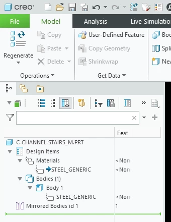

Creating a new part by mirror in an assembly, but there is a missing option (or I can't find it).  In past versions, Pro/E, you had the option to include the datums.  I don't remember what the menu pick was called exactly, (you could choose "Reference", meaning dependent, and with or without datums), but the result was a new part, geometry only, and it included mirrored datum planes from the original.  That way you have something to use for alignment etc when you put the part in other places.
In Creo 9, there is the option to mirror "Geometry with Features", but that is not dependent, so it won't update with the original.  Does anyone know how to mirror the Geometry and include the datums?  Or to make the "Geometry with Features" dependent?

Have you tried using Mirror Component?
In Creo 8 the datums are copied over by default with the settings below.
If you select geometry only and want the geometry to be dependent, make sure to check the box next to Geometry Dependent (not checked in image below, not able to check it when geometry and features option selected).

Thanks, @danders238 .  That's where I started, and you can see the options there that I mentioned.  Probably should have said it was in that dialog box.
If we want it to follow the parent, you must use the "Geometry Only" and "Geometry Dependent".  Here is the expanded model tree.
Anyway, on a full interrogation of the mirror part I do find the body contains axes, and csys, with tags (names of them).  You can select those.
On diving deeper, I eventually found Datum Plane looking things, but no tags, so you can't select unless you pick on the screen, but the tags exist somewhere because they show up in a hover, and by name in the layer (copied from the parent), however, if you interact with them, you get this:
It's possible that PTC once again skipped the Quality Assurance steps (the normal I guess) so now it's a new feature for closing the program.  Anyway, from my original question, I guess there is something there that looks like Datums, but they are not usable.
That's probably the answer - the function is supposed to be there, but it doesn't work.
