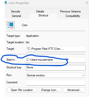

Way 1:. Using start-up directory:
  • place your config.pro in "C:\Users\myusername"
  • change the "Star in" of the Creo short cut to "C:\Users\myusername"

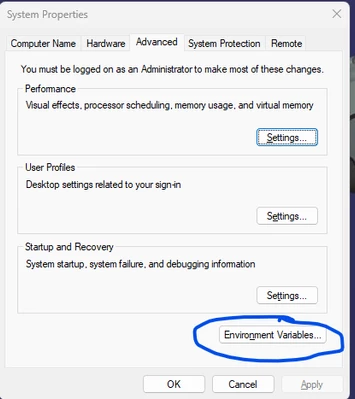

Way 2: Using home directory:
  • define an env variable called "home", set its vale as "C:\Users\myusername"
  • launch Creo from anywhere and your personal config.pro will still be picked up in this case
