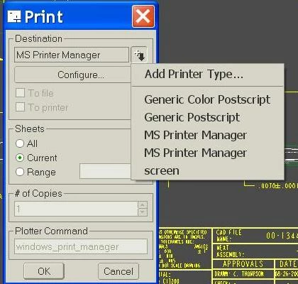

Does anyone know how to create PDFs using Pro-E WF 3.0 (win XP x64) and Adobe Standard 8 (version 8.2.5)? Here is a previous thread on this topic:
    • Response: Aug 09, 2007 05:00 PM
      "64 bit PDF under Wildfire 3.0 was not there because Adobe did not have libraries available. Adobe just released Acrobat 8.1 which allows XP 64 to create PDF directly and the appropriate libraries.
      Wildfire 4.0 has these libraries incorporated and can created PDFs on XP 64."
Although the Adobe PDF is shown as a system printer, it is not available in Pro-E WF 3.0 (see attached image). Is there a setting to solve this problem? What are the steps required to configure Adobe to work with Pro-E on 64-bit systems?

If you print to MS Print Mgr, you should be able to choose from any
printer installed on your system, including Acrobat PDF.
