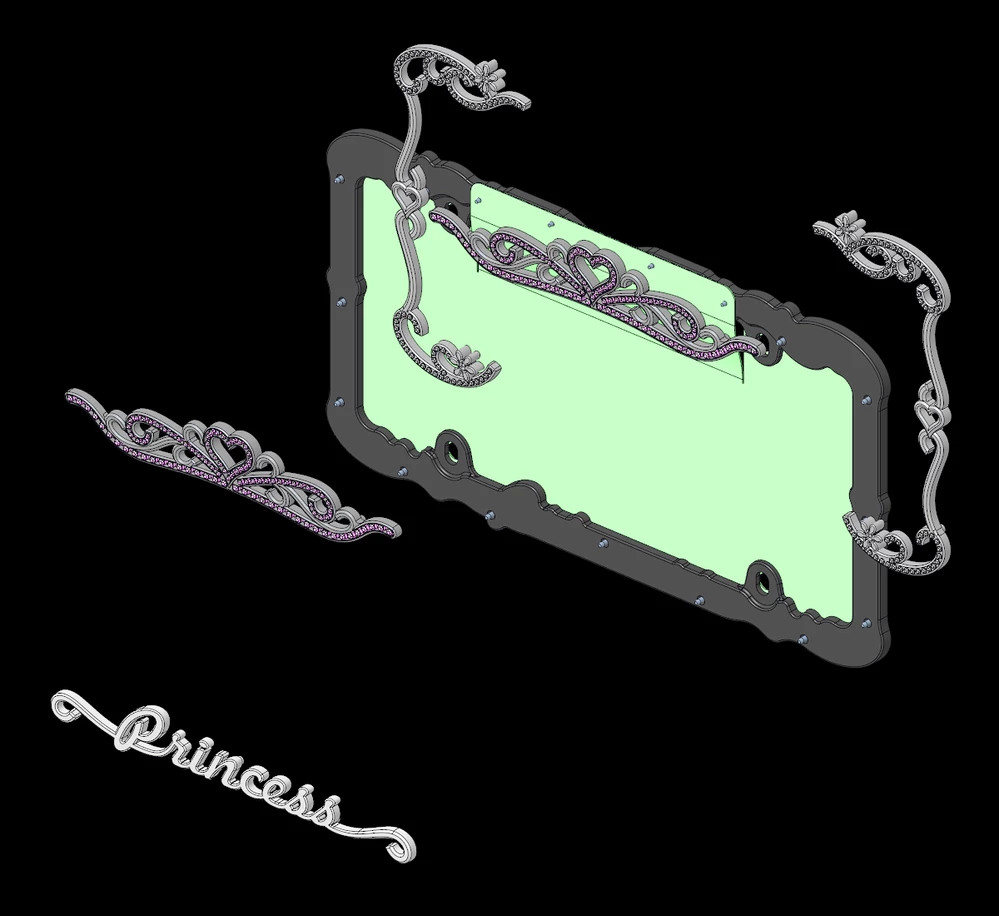

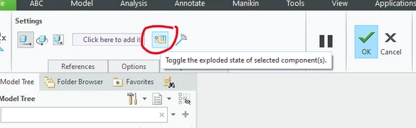

The Toggle Explode is misleading as I mentioned in a response on the other thread.  Now, here is an example where the Toggle does not place components back to the original location like the "Explode > Reset" did.  This is as close as I can get.  If I Toggle explode on any of these, it sends them out into space.
Where is the Explode > Reset Position function?
In case you don't know, there was an excellent function for working with explode states called "Reset" which would put the component back to the original place in space, relative to the assembly or subassembly it was in.  If you were manipulating a position, then decided you did not like how things were looking, you simply reset the position - like an undo for all the moves of that particular component or subassembly.
The above model is an example where the "Toggle" fails to achieve what the "Reset" did.  I say "DID" and "WAS" because it appears (from the previous thread and from PTC tech support) the functionality has been removed.  It is possible that PTC has hidden it so well that we can't find it.  I am hoping that one of you smarter people can show me where it is.  Creo 9.0.9.0

I forgot to ask an important question in the above.  How do you reuse an explode state of a subassembly in the parent assembly explode?
For instance, the decorative piece with all the purplish crystals is a subassembly that has its own explode state.  How do I have that subassembly explode state be part of this top level explode?
Again, that was basic functionality, but I can't find it in Creo.  Thanks for your help.

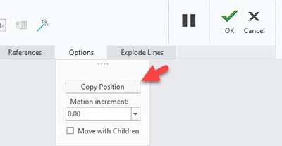

Doesn't Copy Position accomplish the same thing?

Thank you for the responses. Yes, Copy Position is a hack to make it look right - just like starting all over with a new explode state eventually gets there. Yet, both approaches create more work - in the model, and in the drawing - with note and balloon reassignments, fiddling with all the Cosmetic Offset Lines, etc..

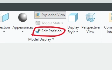

I used the "Edit Position" and then the "Toggle Exploded State" button. (Creo 7.0.9.0)

Until it is implemented, copy position is your best bet to quickly move it to the same position as another part/subassembly
