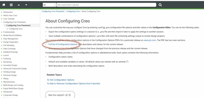

https://www.ptc.com/en/support/article/CS79007
They are here:
Creo Installation:<common files>\help\reference\pma\usascii\configoptions.pdf
or here:
https://www.ptc.com/en/support/refdoc
change the doc type to config options

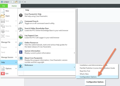

Aug 13, 2025 11:19 AM UTC
you can access it from :
or from the help center :
Patriot_1776
Aug 13, 2025 7:03 PM UTC
Ok, now THAT is actually useful, I'd never seen that before.  It appears to work, thanks!  I can't believe I've never seen that before and nobody I know knew about it.
