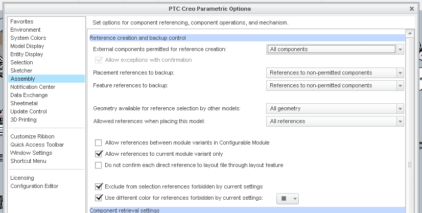

I am trying to reference external features in assembly mode but can't.  Where has the model reference scope control command gone in Creo?

File - options. The first option is what used to be scope.
