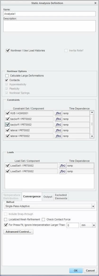

If I have a patterned part (20 times say) and that part has constraints and loads defined in it, does the order of appearance of the constraint and load sets in the analysis definition form appear in the order of the patterned part?
Example analysis definition form below showing a component's loadsets and constraint sets when patterned twice.

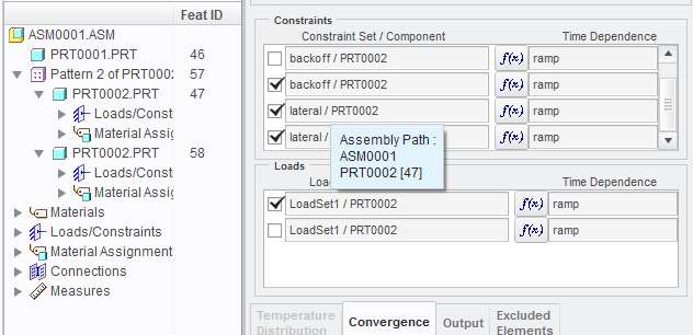

I know I can test but there is no way of telling which pattern element a constraint/loadset is associated with.
More than 2 elements in a pattern and it gets mighty confusing compounded by having to scroll up and down in the definition form as it's not possible to see more than 5 constraint sets/loadsets at anyone time.
