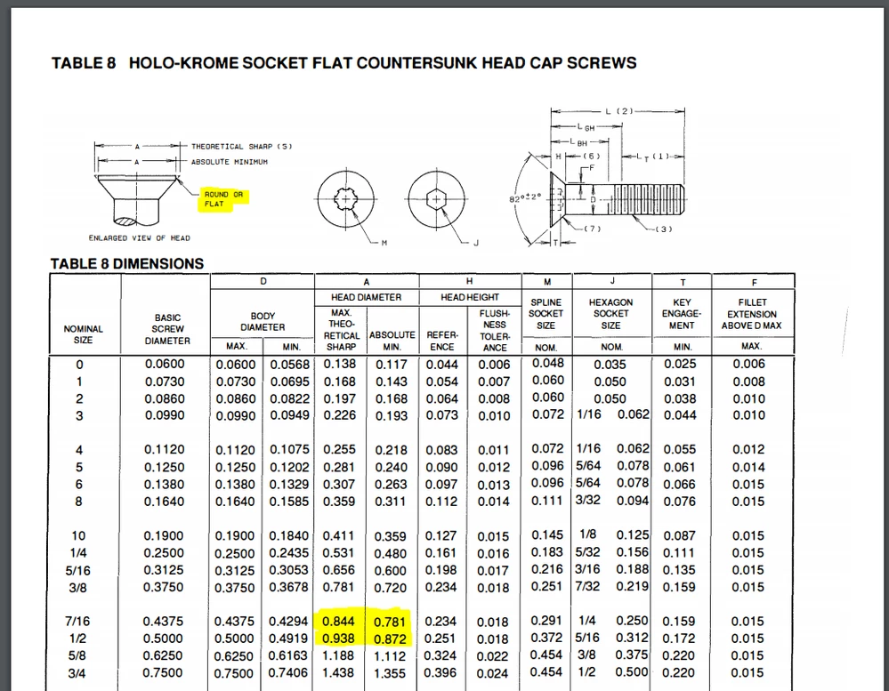

We don't model the threads of a screw for various reasons. When modeling a flat-head (non-countersunk) screw, the geometry of the head (height, dia, angle) automatically determine the 'body' of the screw. Therefore, if you want an accurate 'thread body' size, you would need to have an inaccurate head angle, height or diameter. We had chosen to keep all head dimensions accurate (angle, max dia, max height) and use the body as-is. Some users are getting confused. I checked a random screw from the 'Intelligent Fastener' system and it seems like they chose to not have an accurate head diameter. I would assume a head diameter is more critical to a thread body size, if the part name is saying it is an "M5". What is everyone's thoughts? How do you approach this conundrum.

OK. After looking at my assembly I posted earlier, I realized that I never tested a scenario with an incorrect head height. It turns out, an incorrect head height doesn't impact the height placement of the screw in the hole. The only factors are angle and the theoretical sharp max head diameter. Therefore, it seems like McMaster's approach was the best one after all.
In your last post, since the model doesn't have a sharp edge, then the theoretical sharp is actually larger than 9.2, which is larger than the max in the spec and will raise the screw higher in the hole. This is screw 'E' in my earlier assembly.
Thank you for going back and forth with me on this. I believe based on the assembly testing I've done the best approach is to have an incorrect head height, which doesn't impact placement and allows for the thread body to be nominal.

Real fasteners are never sharp like that.  We typically show a radius or a flat and then set the diameter equal to the actual size as measured on our actual fasteners, somewhere between the 'theoretical sharp' and 'absolute minimum'.
https://www.holo-krome.com/uploads/7/2/7/5/72754089/hk_consolidated_tech_manual_full_2015.pdf
Page 18:

One thing that recently stung me about this is for some of the short screws (i.e. 1/4-20 X 1/4 long) the head is actually undercut. Not having the undercut made the geometry goofy.
For me, the FHCS has to have the proper angle (to go with the countersink in the mating part) and I also define the head height and head diameter. The "flat" cylindrical portion of the head just "falls out" based on the height and diameter (the diameter is less than the theoretical sharp).
