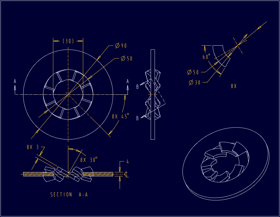

I have received a drawing from customer.
I can't understand the drawing, Please guide me.
I have attached screenshot please view it and give your valuable commens.

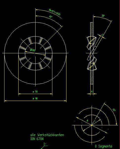

Technically, this is what the drawing defines without further information. No method of attachment of the vanes. Also, dimensions b & c are assumed as 30 and 50, although it leaves a non-circular center. Post machined? Are b & c accommodation values to better represent a circular center and circumference?
If the original drawing is a DXF, you should be able to get b & c values, but looking at the drawing, and the vane thickness of the other vanes in the section, I might not trust that either.

It looks like an air diffuser plate. The outside circle is a "plate/ring" of material. The inside eight items are vanes that once cut (probably laser cut) are bent on a 30 degree angle. with the edge of the vanes still attached to the "plate/ring". I saw them a lot in the boiler industry to create a swirl in the air stream to mix air and fuel for combustion. The inside circle is a void - or absence of material.

The drawing is certainly not complete... is it a stamping, is the vain interface to the disk welded? Essentially, the details of the transition is missing. If it is formed, then the internal tooth star washer is agood example.
