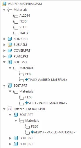

simple question: Does anyone know why you can add materials to assemblies? You used to not be able to do this, but in Creo 5 you can. You still can't assign any material to the assembly, so what's the point of being able to add materials to it? They don't seem to be used for anything? Does anyone have a use case for this? why was this functionality added?

It's for defining flexible (variable) materials in assembled components. Thanks to that you can define various materials at assembly level and then use this materials to assign specific material to a flexible component. It allows you to insert multiple models and vary materials for every one of them depending on their occurrence (materials you can assign to a flexible component are restricted to only ones defined in the assembly) like this:
As you can see, even though the original model has been assigned a material, at the assembly level it has been changed to a different material for every occurrence of the model.

Jan 3, 2020 7:18 AM UTC
Jan 3, 2020 4:24 PM UTC
Thank you! That's an interesting use, and makes sense. My curiosity is sated.
