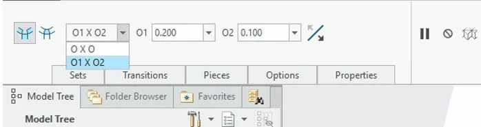

Why Creo is showing only two options for Chamfer? OXO and O1XO2 ? Not showing Angle x D
  • July 8, 2020
  • 3 replies
  • 1651 views
Hi All,
Its strange that I am trying to apply a chamfer on one corner i.e. in the form of Angle x D. But creo is showing me only two options i.e. OXO and O1XO2. Please see below screenshot.chamfer..JPG
Can anyone, please explain the root cause of it.? I want Angle X D as well Thank you in Advance.

I guess that root cause of it is your model's geometry.
July 8, 2020
The options that are available in the chamfer tool menu are dependent upon the geometry you have selected. As far as I can tell (minimal testing), the "AnglexD" option is only available if you select an edge. Do you have surfaces selected?

The type of DxD,D1xD2, AnglexD and 45xD are available for edges of two flat surfaces only. For your data, the chamfer references might not matching with this condition.
