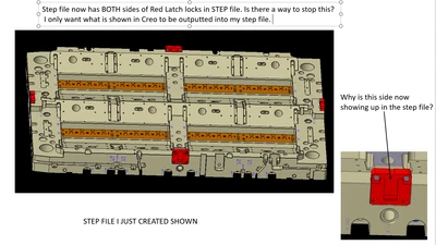

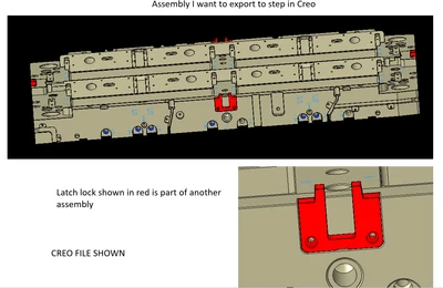

Hi guys, when I want to Export a STEP file of ONLY what is shown on my screen, I always get some assemblies that show up that should not. Like the layers get messed up.
See pics below.
How can I fix this so ONLY what is currently shown on my screen is exported out to STEP?

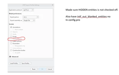

Perhaps the latch solid model also has the other side of the latch included as a surface?
In the export settings, try unchecking "Annotations" and then "quilts" and then export the STEP file...
March 7, 2022
Unfortunately I tried that, I get the same result.
Putting them on simplified reps like mentioned above works, but its a ton of work on large assemblies.
It only seems to happen (as far as i can see)  on assemblies inside of assemblies.
March 8, 2022
maybe latch lock is included in more than one layer and these layers are "conflicting" -OR- latch lock is not included in any layer ?
March 8, 2022
No conflicting layers. I am willing to bet its because its an assembly inside of an assembly.
I have submitted this with files and video to PTC, and they told me they can repeat this problem on their end.
This has been a problem for many years...and I usually just try and work around it. But figured i should see what the official explanation is as to why this happens.
