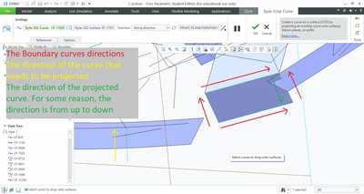

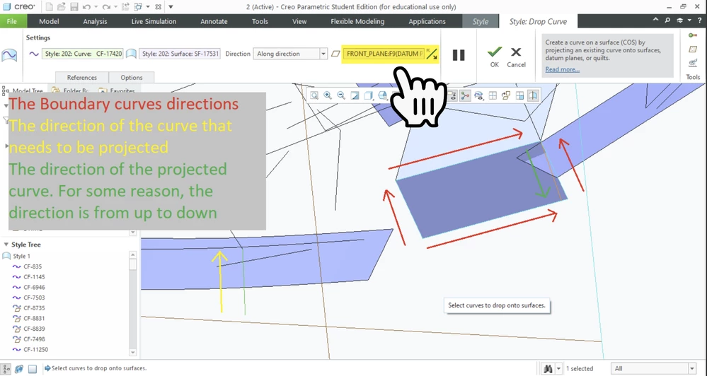

Hello. I model my own car in Style Tool and face a small problem. I don't understand why does curve direction flip after dropping it on a surface? Here is a picture to make it more clearly for you.
In this picture, there are directions (End 1, End 2) of all curves I need that are marked by arrows.
So, my question is: How to make the direction of the projected curve (the arrow of yellow color) from up to down. Thank You in advance.

Try changing the direction and/or the along direction reference which will alter the normal vector used for the projection calculations.

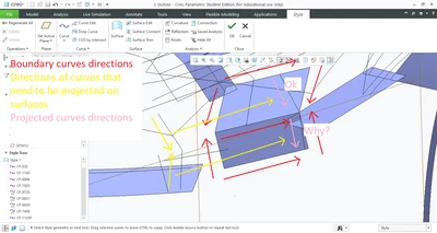

I decided to show what curves directions I have now:
As you can see, the projected curve on the bottom surface goes from top to bottom, and I want it to be from bottom to top. How can I get it? Is it possible to make it?

This capability is enabled in Edit Curve environment. Approach is illustrated in little movie attached, and documented in the To Create a New Curve section of Creo Parametric Center as follows:
If required, to reverse the curve direction, right-click the curve and choose Flip Curve Direction.
Hope this helps,
If not, please tell us which kind of curve it is (free curve? curve on surface? ...) and which version of Creo Parametric you're currently working with (movie recorded here in version 7.0).
