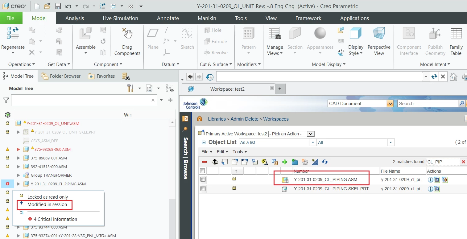

why does locked object show "modified in session" in the server status column of Creo 6.0.4.0?
I am using Creo Parametric - Release 6.0 (connected) 6.0 6.0.4.0
Y-201-31-0209_CL_PIPING.ASM is locked in the workspace,but it will show "modified in session" in the server status column,please see the attached screenshot.would you please check if there is a problem with status?

Just guessing but since the assembly that is showing modified has "piping" in the name, if the assembly has external references, when the model is regenerated, the assembly will "change" based on the references and will be "modified in session" but since it is locked in PDMLink, it will not save to the workspace. There are other reasons a model will "change", such a relations that could cause a "modified in session".

thanks for your help.i got answer from PTC support,the response are as follows:Model regeneration failure causes the object to be modified. Fixing models can avoid this warning.
