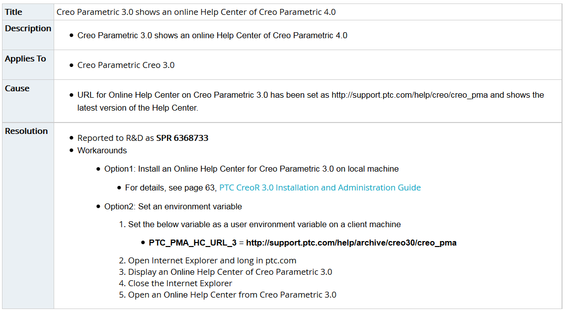

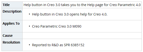

why on creo 3.0 the button guide ( up and right ) opens the guide of creo 4.0 ?
why on creo 3.0 the button guide ( up and right )opens the guide of creo 4.0 ?
see the pdf attacked
TY

January 23, 2017
It's a known issue.  PTC will have to either fix it on their webserver or fix it in a future build of Creo 3.
https://support.ptc.com/appserver/cs/view/solution.jsp?n=CS254679
January 23, 2017
All,
This is fixed in Creo 3 M120

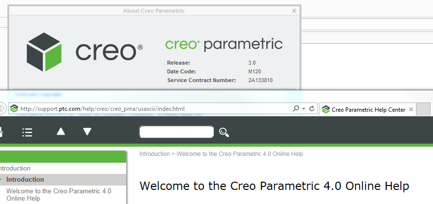

January 23, 2017
Are you sure?.  We are running M120 and the help button still takes us to the Creo 4.0 online help.
January 23, 2017
Tom,
My mistake. We have our config.pro pointing to Creo 3.0 help located on a server.
January 23, 2017
you can download and install Help on local disk to avoid this problem.
