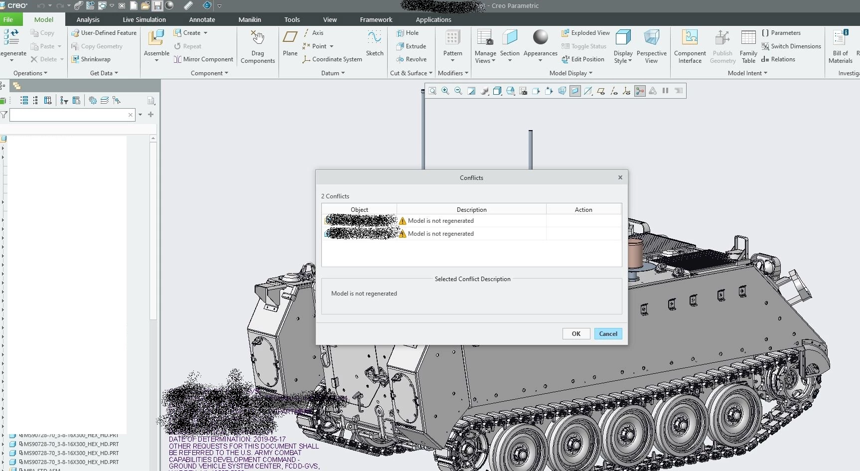

Why the annoying window of regeneration pops up every time I save
How to get to system stop doing this? See image

Van_AG
try changing the regen_solid_before_save option value in the config to something other than the default

Yogesh.T
Yogesh.T14-AlexandriteAuthor
I think Yes should be it? Correct?
Yogesh
try it and you will see ...
