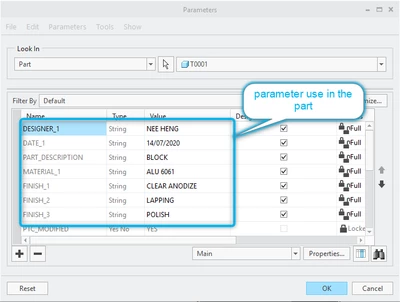

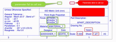

I set few parameter in the part. but it fail to show in my drawing. if i use "note" key in my customize parameter , it able to show. but it just can not show in table.
possible to advise , how to solve this problem.

1.] basic rule ... parameter callout must be included in table cell

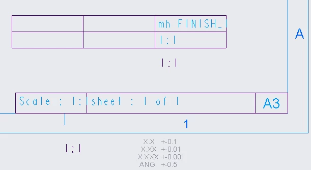

I opened matte_solid.prt, added some geometry and modified user parameter values. In your original model all user string parameters does not contain any value, they are empty !
2.]
I created drw0001.drw using matte_solid.prt and a3_drawing.frm. Everything is OK - see picture and uploaded zip file.
3.]
I hope you know that when format (.frm) is added to a drawing (.drw) then Creo copies all tables from the format into the drawing. All other items available in the format are linked to the drawing.

If you want the model parameter to be used then you need to have the parameter name followed by :mdl so make sure that the table cell in the format is &FINISH_1:MDL for instance. If you don't do that then it defaults to using a parameter from the drawing.
