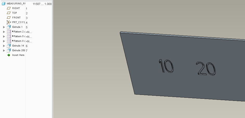

I am currently trying to make a long metric ruler in PTC Creo Parametric 3.0. I have been able to apply the millimeter tick marks across the ruler. I was also able to extrude the number 10, but when I try to extrude any other numbers, such as 20 and on, Creo says that the feature has failed, but I am unsure of why. Any help on this would be greatly appreciated.

It's an relative accuracy issue. Long part vs. small features. Go to FILE - PREPARE - MODEL PROPERTIES - and edit the accuracy. You will either need to make the relative accuracy much smaller or change to absolute accuracy. Accuracy affects regeneration time so the higher the accuracy, the longer the regeneration.
I surpressed your tick mark pattern to make it "reasonable" to regenerate.
